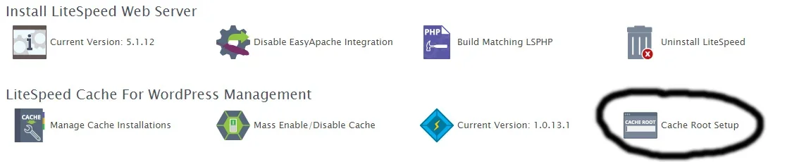

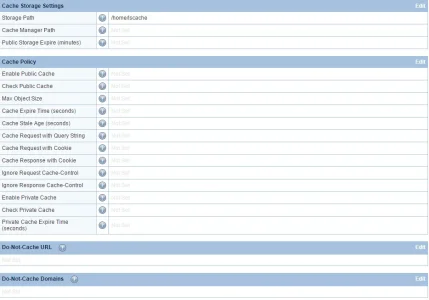

Webadmin>Server>Cache settings
I followed the instructions in this link with no luck and prior to that via WHM>litespeed, I used "Cache Root Setup" to set up the cache folders.. I don't have wordpress but I assumed that would work..hope I didn't mess something up by doing that.
Hi @bloop
Your settings seem to be correct. Perhaps the issue is simpler than we thought: are you visiting your site with a non-logged in browser? Logged in users will not see cache hit or miss.
