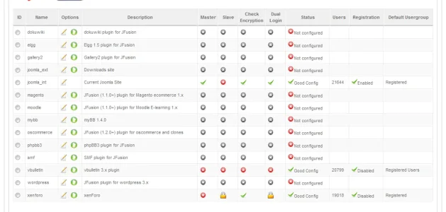

... but I don't seem to be able to configure it that way. The 'Slave' and 'Dual Login' options are both 'padlocked' in the main JFusion Plugin Configuration page.
JFusion 1.5.5
J! 1.2.23
XF 1.0.2
-- hugh
OK, made some progress.
For some reason the 'slave' and 'dual_login' fields in the xenforo row in the #__jfusion table were set to 3. I set those both to 0, reloaded the JF Plugins page, and was then able to enable both settings. I didn't look to see why those fields got set to 3 in the first place, BTW.
