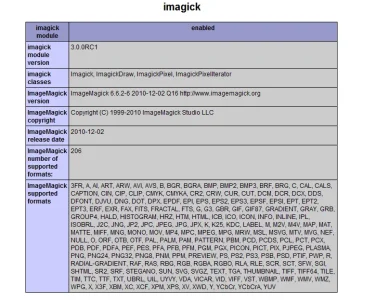

To verify that ImageMagick is working
check your php info .. You should see This : imagick.webp
This is provided by php5-imagick on a Debian with a simple apt-get :D (Other NIX like CentOS or RHEL .... servers need imagick.so properly compiled and added in php.ini)
