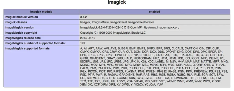

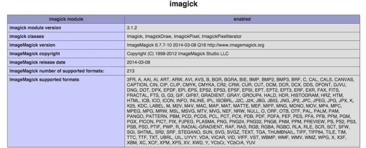

Your ImageMagick version appears to be old. Notice the difference in the ImageMagick version portion. Yours is 6.2.8.
From my Debian VPS
From my CentOS VPS
Not going to guarantee this is the problem...but you should upgrade to the latest supported just for general purposes.
