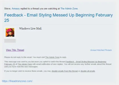

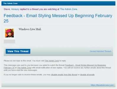

@Arty there was a complaint of the email not displaying properly in Windows Live Mail (Outlook). I verified this as well.
Windows Mail
Gmail
If you need anything else tested let me know.
Thanks for report. That issue has been fixed in next update.
Its one of reasons why update takes so long to release - I had to restructure layout to account for web mail clients.
