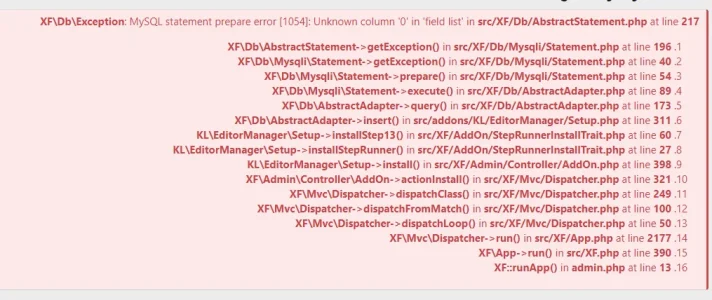

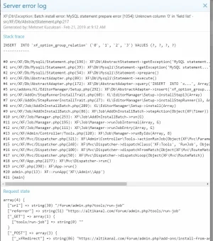

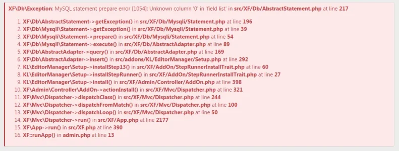

Fehlermeldung des Servers
XF\Db\Exception: Batch install error: MySQL statement prepare error [1054]: Unknown column '0' in 'field list' src/XF/Db/AbstractStatement.php:217
Generiert durch: webmaster 21 Februar 2019 um 08:31 Uhr
Stapelverfolgung
INSERT  INTO `xf_option_group_relation` (`0`, `1`, `2`, `3`) VALUES (?, ?, ?, ?)
#0 src/XF/Db/Mysqli/Statement.php(196): XF\Db\AbstractStatement->getException('MySQL statement...', 1054, '42S22')
#1 src/XF/Db/Mysqli/Statement.php(39): XF\Db\Mysqli\Statement->getException('MySQL statement...', 1054, '42S22')
#2 src/XF/Db/Mysqli/Statement.php(54): XF\Db\Mysqli\Statement->prepare()
#3 src/XF/Db/AbstractAdapter.php(89): XF\Db\Mysqli\Statement->execute()
#4 src/XF/Db/AbstractAdapter.php(172): XF\Db\AbstractAdapter->query('INSERT  INTO `x...', Array)
#5 src/addons/KL/EditorManager/Setup.php(292): XF\Db\AbstractAdapter->insert('xf_option_group...', Array)
#6 src/XF/AddOn/StepRunnerInstallTrait.php(60): KL\EditorManager\Setup->installStep13(Array)
#7 src/XF/AddOn/StepRunnerInstallTrait.php(27): KL\EditorManager\Setup->installStepRunner(13, Array)
#8 src/XF/Job/AddOnInstallBatch.php(289): KL\EditorManager\Setup->install(Array)
#9 src/XF/Job/AddOnInstallBatch.php(86): XF\Job\AddOnInstallBatch->stepAction(Object(XF\Timer))
#10 src/XF/Job/Manager.php(253): XF\Job\AddOnInstallBatch->run(G)
#11 src/XF/Job/Manager.php(195): XF\Job\Manager->runJobInternal(Array, G)
#12 src/XF/Job/Manager.php(111): XF\Job\Manager->runJobEntry(Array, G)
#13 src/XF/Admin/Controller/Tools.php(120): XF\Job\Manager->runByIds(Array, 8)
#14 src/XF/Mvc/Dispatcher.php(321): XF\Admin\Controller\Tools->actionRunJob(Object(XF\Mvc\ParameterBag))
#15 src/XF/Mvc/Dispatcher.php(248): XF\Mvc\Dispatcher->dispatchClass('XF:Tools', 'RunJob', Object(XF\Mvc\RouteMatch), Object(NF\TeamSpeak\XF\Admin\Controller\Tools), NULL)
#16 src/XF/Mvc/Dispatcher.php(100): XF\Mvc\Dispatcher->dispatchFromMatch(Object(XF\Mvc\RouteMatch), Object(NF\TeamSpeak\XF\Admin\Controller\Tools), NULL)
#17 src/XF/Mvc/Dispatcher.php(50): XF\Mvc\Dispatcher->dispatchLoop(Object(XF\Mvc\RouteMatch))
#18 src/XF/App.php(2177): XF\Mvc\Dispatcher->run()
#19 src/XF.php(390): XF\App->run()
#20 admin.php(13): XF::runApp('XF\\Admin\\App')
#21 {main}

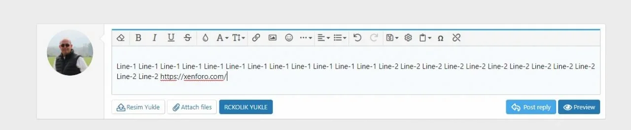

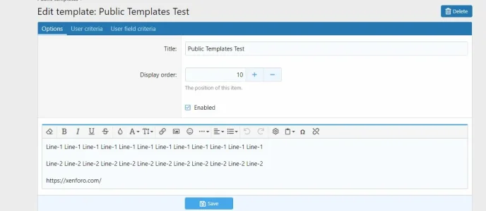

Find some small issues and want to report :
1- Public and Private Templates content does not import into post properly. As you can see there are 3 lines at templates but it is added as one line into post.

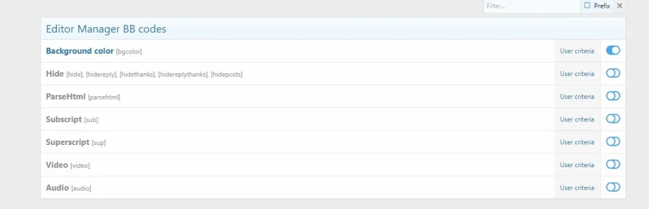

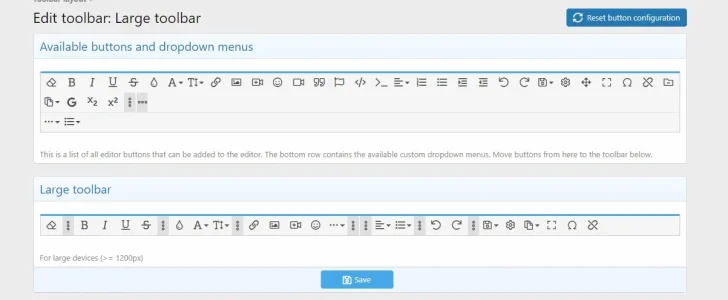

2- Although " Background Color" BBCode is enabled, it is not shown at Toolbar layout.
