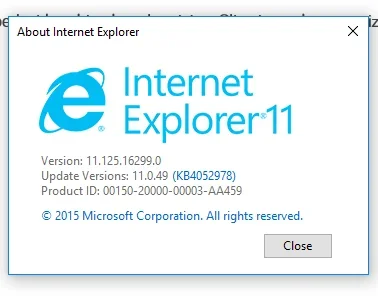

OK, heard back from one of the users:
Windows 7, gets all automatic updates.
IE11 version 11.0.9600.18837
Update versions 11.0.48 (KB4047206)

Hi
I'm one of the members that doesn't get the tables in IE 11
Using windows 10

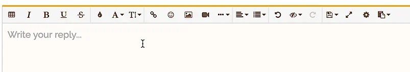

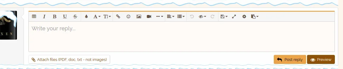

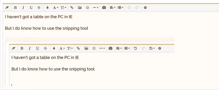

Copy of post from forum in IE
Copy of post with Firefox

@Jeanette when viewing on IE, although we can see you are seeing the default layout instead of the custom layout, do you still get the custom option for text background (as well as default text colour only ) under the text color icon?
