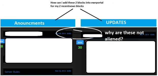

hey i was trying to do something like that picture displays with the title blocks for the 2 recentnews blocks but couldnt get it working.
I attached a picture, if someone can help out i wouldnt mind paying for the help.
