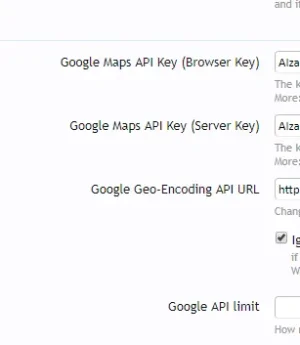

Does that mod use the Google Maps API?I am currently using Crispin's user map for XF1
Can you link me to the mod so I can look into those features further?
