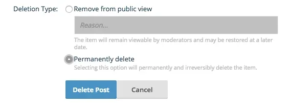

Tried again by "creating a thread". Got the 10 credits
the I did the physical delete and it still doesn't get reversed. I keep the 10 credits.
BUT
If I "reply to a thread" I get the credits and when I delete the reply it got reversed and I lost the credits.

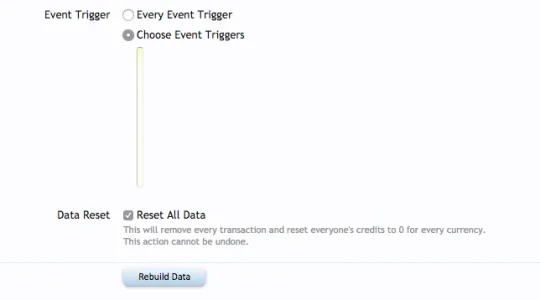

I did some testing regarding the recalculations.
Feedback:
#1
As seen in the screenshot you can not select the events:
#2
Even when I uncheck "Reset all data" all my credits were still reset to 0
#3
None of the events were recalculated. Everything is 0
I've resolved a few issues with the rebuild and completed the rebuild @ your site, feel free to have a look over and see if anything seems wrong to you :)
