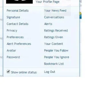

1. I recommend having the Credits link for the transactions/wallet page (like the navtab link) also available as an option to locate inside the member dropdown area. You know, where the member can select their preferences etc)

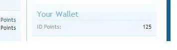

2. I think the Purchase points tab should be located in the wallet itself instead of where it is right now. Maybe also have a tab at the wallet for donations too.
Like /Wallet/Purchase/Donate Tab arrangement.
I'm not sure what you mean exactly but the fact is that Purchase events are tied to currency IDs, therefore they can only really show up when we have context (e.g. the currency popup overlay).

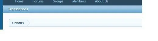

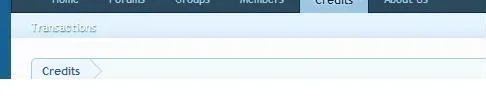

5. When I click on the Navtab link for Credits, I get this navigation bar over where the subnav bar normally is, with a Transaction link that just leads me to the same page. Should this just be removed so it doesnt interfere with the layout and since the link only shows up on the page you are already on?
Sorry I don't know what you mean by "navigation bar over where the subnav normally is". Could you clarify please?

1. example... to have the credits link option located here,...
2. buy points here link,...
5. the comparison I found in subnavbar is the two images here, top normal, bottom abnormal is the "left" choice in navbar option,...
normal:
abnormal:
This will be resolved in an update on Monday :)
