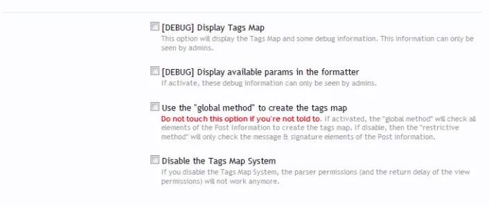

    On previous versions the problem was I had forgotten an important element of the message: the signature which can contains some Bb Codes. So the Map was not accurate. This problem has been fixed, so my debug function which was not accurate too. 4 debug optionsare now available in the administration:
    1. Display the tag map (only to admins)
    2. Display available params in the formatter => to create the the tag map (only to admins)
    3. Use the "global method" to create the tags map: by default only the message & signature elements of the posts are used now to create the tag map. This global option will take all elements of the posts (only strings) to find Bb Codes.
    4. Disable the Tags Map System: if you have problems with the tags map, you can disable it => the Bb Codes parser permissions will not work anymore.

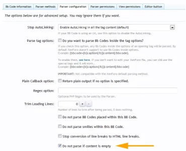

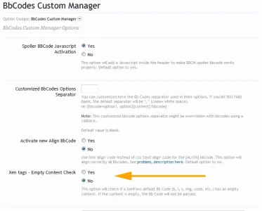

  • Empty Bb Code Content Check for XenForo Tags and Custom Bb Codes. If content is empty, you can prevent the Bb Code to parse.
    1. For XenForo Tags, this option is available in the Bbcm admin options (disable by default)
    2. For Custom Tags, this option is available in the Bb Code configuration page (enable by default) - so it can be configured Bb Code by Bb Code

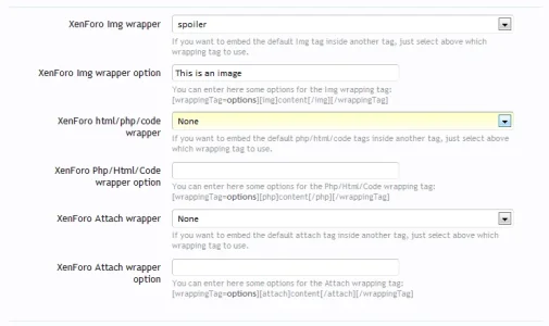

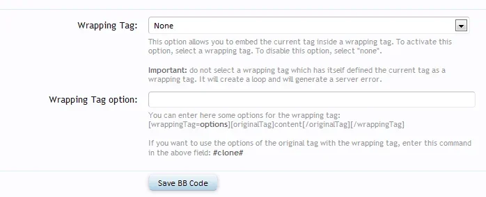

  • Bb Code Wrapping Function for main XenForo Tags (img, code/html/php, attach) and Custom Bb Codes. With this option you can automatically embed a Bb Code into an another one.
    • You can also define the wrapping Bb Code options:
      [wrappingTag=[B]options[/B]][myBbCode]content[/myBbCode][/wrappingTag]
    • You can use a parameter to copy the wrapped Bb Code options to the wrapping Bb Code options

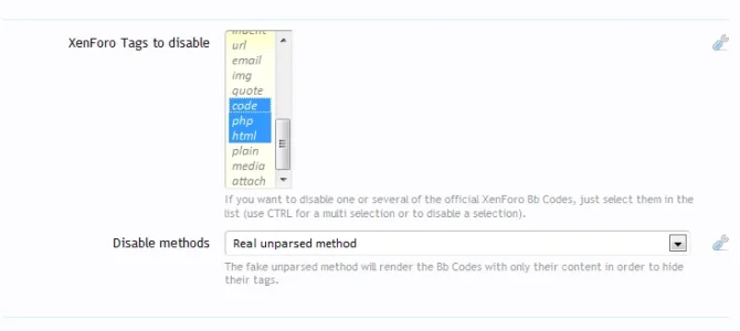

  • Fix a bug with the Bb Code content protection => was causing a parser bug with attachments
  • New option to disable XenForo Official tags
