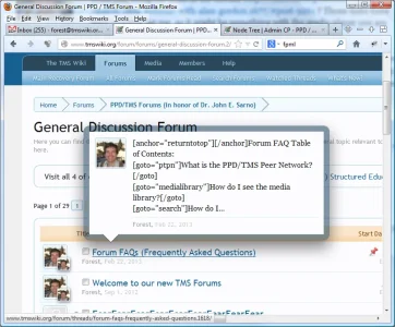

I don't know if this would be a major upgrade, but one thing I've noticed is that the BBCodes don't render fully in content preview tooltips. See the following screenshot, for example:
Is there anything that can be done about that?
That's a normal behaviour their: the parser is not called here. It should be possible to update the code to only render the content without the tags, but this requires further checks.

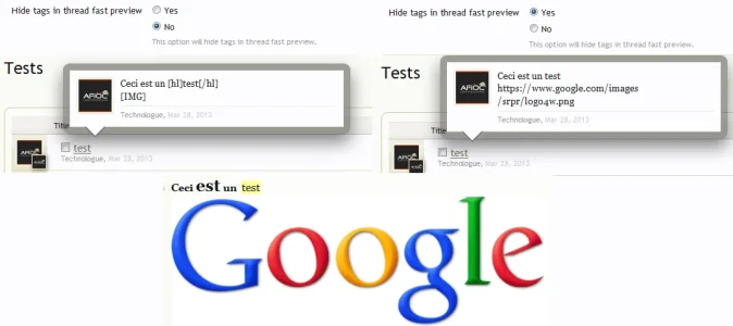

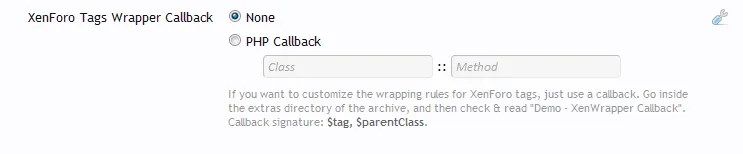

Version 1.3.7 - Change Log:
link to download
  • New option to hide tags in the thread fast preview window
  • New callback to configure XenForo Tags Wrapping Options
    => See archive "extras" directory and have a look to "Demo - XenWrapper Callback"

Version 1.3.7.1 - Change Log:
link to download
  • Fix a typo mistake which hidded tags not only in the fast preview window but in all pages using json (when the option was activated)
