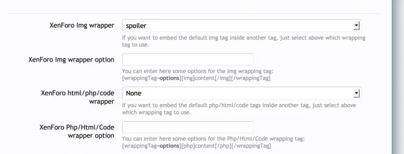

So I've got the IMG wrapper setup to be spoilered every time its used. What "option" (in the box below) would I need to add to that?
Or, in other words, what's the Xenforo Img wrapper option for if you've already got the dropdown box above?
As to the rest, not trying to be a pain in the ass. Just curious if something like that was possible.
I don't know which spoiler tag you are using but if this spoiler tag can have an option, then yes you can configure an option from here.
Let's say the spoiler tag lets you select a title:
[spoiler=Title]Content[/spoiler]
You can enter in the option field the default Title to display for the spoiler tag used as a wrapper of the XenForo img tag. In other words your img Bb Code will behave like if you have written this full code:
[spoiler=Title][img]....[/img][/spoiler]
If you don't specify any option, this will be like writing this:
[spoiler][img]....[/img][/spoiler]
