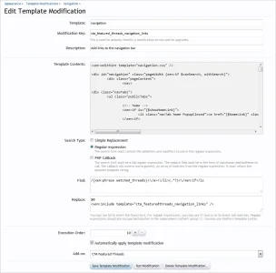

On my board, when the browser window is displayed on certain screen sizes (widths), the Featured Threads (Works) submenu item disappears behind the ellipsis (...), while the Featured Threads Archive item remains visible. (See screen cap.) I would like for the Featured Threads item always to appear before the Archive item. How do I accomplish that? I know it must involve editing the display order somehow in code listeners, but I'm not sure.
Thanks.
It's related to the 'navigation' template modification.
You would have to enable debug mode and change where the template is inserted, which is currently after 'Watched Threads'.
You can rename the phrase to 'Archive', which will make it much shorter and it should remain visible then.
How would I get Featured Threads never to disappear behind the ellipsis? I'd prefer to have that first or right after Watched Threads. Thanks.
It's not possible to stop the menu items being removed as the width narrows.
All you can do is move them as far to the right as possible, as they are removed from left to right.
