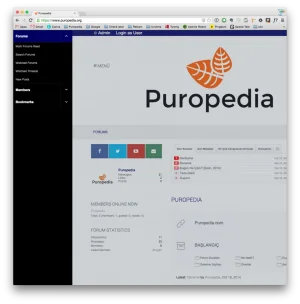

I created a super admin and send you details.so I would need to see actual links to try and understand the issue.
I gave Brogan super admin access. If you want, I can create an account for you too.@puropedia your home page isn't visible to guests - when I click on it I am asked to log in. Maybe if guests could view the page it would be easier to follow what your problem is.
I believe it's due to all the route filters you have defined.

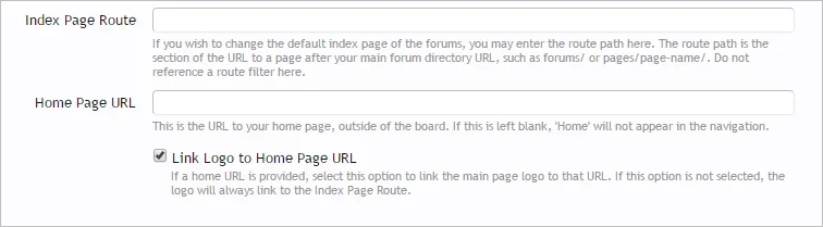

I am not sure, because I disabled all route filters; then I set Home Page URL as "threads/featured/" and Index Page Route as "forums/", but problem still continues.I would suggest entering the route there for your preferred landing page, whether that be forums/ or threads/featured, or whatever you want it to be.
It's not a major problem anyway. Just annoys me.It's certainly not an issue I have ever seen before and the code follows the XF standard so there's not really anything I can do to change it.
That's not correct.I am not sure, because I disabled all route filters; then I set Home Page URL as "threads/featured/" and Index Page Route as "forums/", but problem still continues.
This does fix the problem. Thanks!Do not have the trailing slash for the index route and leave the home page URL blank.
What I was trying to do is setting forum page as puropedia.com and FT page as .com/threads/featured and making puropedia.com as my home (landing) page. I guess, I will have to settle.That assumes you are using the FT page as your home page.

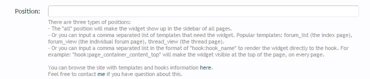

Thanks @Martok ,Yes you can, because @Brogan has thoughtfully added hooks into these templates.![]()
In that case, set the index route as forums/.What I was trying to do is setting forum page as puropedia.com and FT page as .com/threads/featured
Have you read the guide on using the conditional statements?I thought we could insert some widgets just below the first block. not all blocks.
