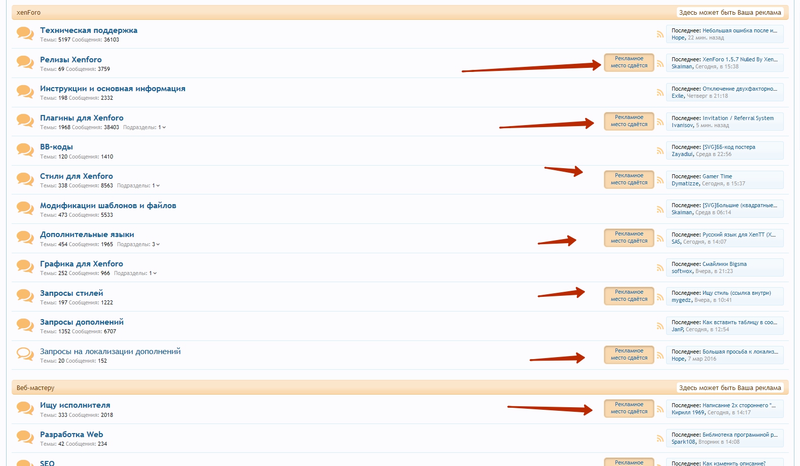

Hello, is it possible to set banner position like in this photo below?
If yes, how can i do it?
There is a position but it works with the description enabled. The position is under "Description Forum Node ID" category.
I'll see if I can add a new position that works without description.
