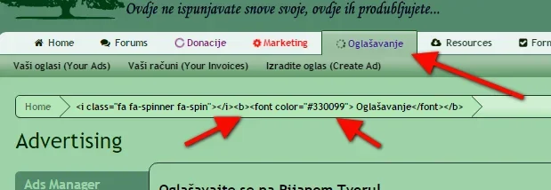

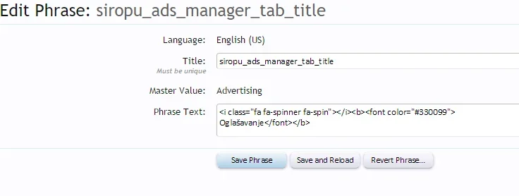

How to setup phrase to not show html in breadcrumb? On Tab html is parsed Ok, but in breadcrumb is not parsed.

@Sunka, the problem is with how XF parses the phrase in breadcrumbs. If you want to use HTML in breadcrumbs go to navigation breadcrumb template and change {$selectedTab.title} to {xen:raw $selectedTab.title} I will see what I can do about the tab position.
