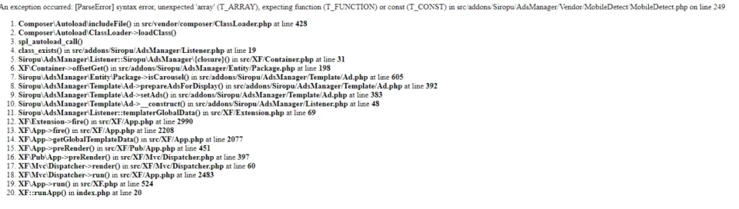

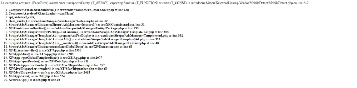

I updated to the recent versions of Ads Manager 2 and Keyword Linking. After reactivating the forum, the complete site was down. Got the two error messages below and 400 error messages in ACP. I deactivated both addons and my site is up and running again. But, of course, I want both addons live again, esp. the Ads Manager... What can I do?

I have made a change to the current version. It will use the mobile detect version based on the php version you are using.
