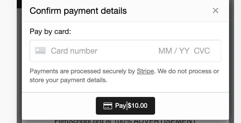

How do I add the code for the button clicking? Which template do I need to edit for this button for stripe payments:
You can add it to the end of this template account_upgrade_purchase
