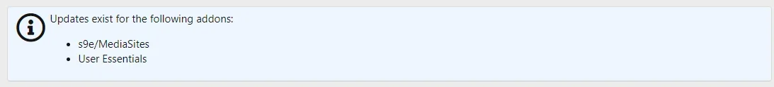

I updated s9e/MediaSites a couple of days ago, yet it still shows that an update exists for it:
However, this is exactly the version I installed.
If you hover the 2.10.2 text there it says what the problem is :)
Basically:
  • The XF resource page has released it as version 2.10.2 (which is the version 2100270, and our system sets it like that)
  • The actual version in the addon.json is 2100250, which is actually 2.10.2 Release Candidate (older version than what the XF resource page shows)
  • 2100270 (what our system extracted from resource page) is larger than 2100250 (actual installed version), so it shows that there is still a newer version, although there isn't..
I now marked that version correctly in the backend, but in the future:
Solution
When you see things like 2.10.2 after you have clearly installed the latest version, you should click the ⚙️-button, and select "Ignore this version" and it won't show about that specific "broken" version until there is a newer (hopefully correctly marked) version available :)
(and if the next release is also "broken" you just rinse-and-repeat the install actualy latest version + "ignore this version" :D, maybe also tag the developer to do it correctly in future ;) )
Alright, thanks! And thanks for marking the version correctly.

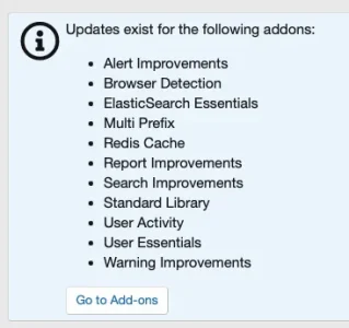

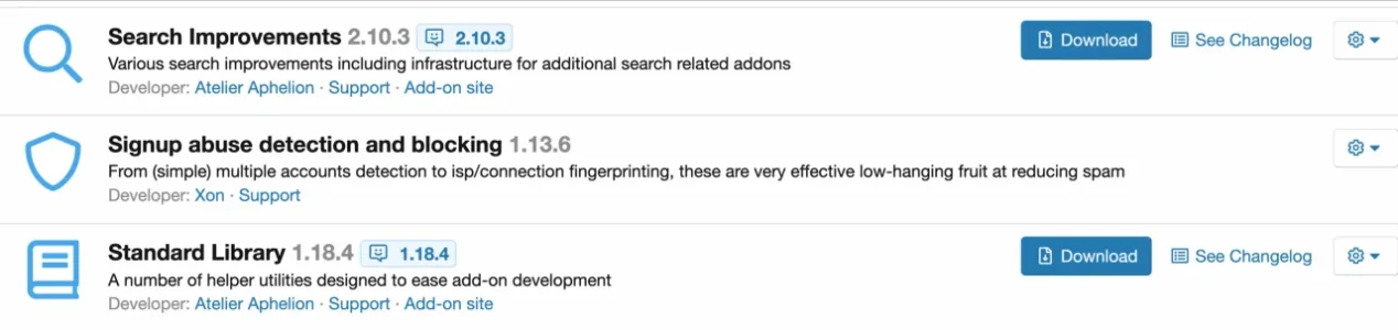

It seems like the latest backend detects an update in some of @Xon's add-ons, but there is no actual update for his add-ons:
