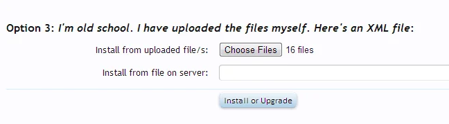

This version brings with it a small new feature that allows you to install multiple XML files with only one cache rebuild.
The file input now accepts multiple files:
56766
Once you click install, it processes each one of the XML files, but doesn't run a cache rebuild until the end of the process.
This makes it possible for you to very quickly batch install lots of add-ons.
