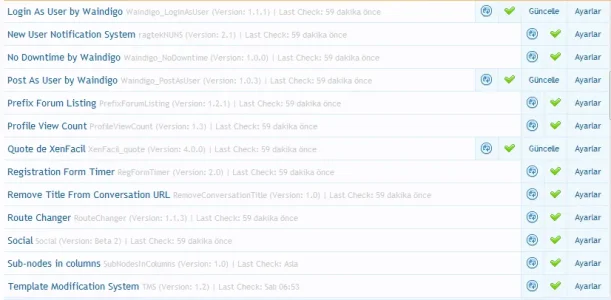

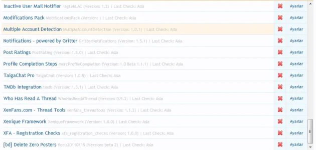

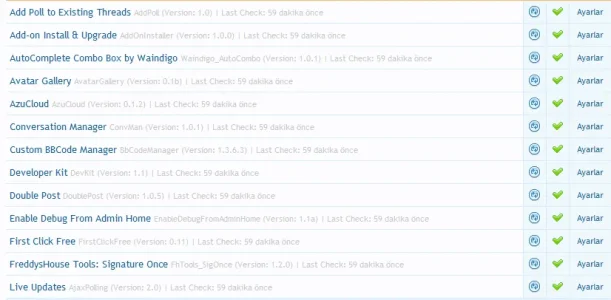

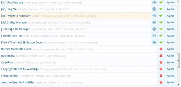

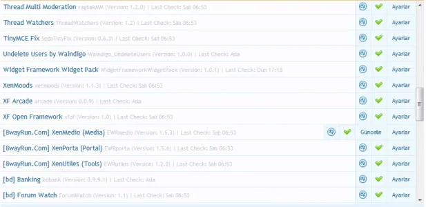

I've written the links to the resource manager, not external ones or deleted resources.
Here are all the screenshots:
This is the output:
string(28) "Add Poll to Existing Threads"
string(24) "Add-on Install & Upgrade"
string(34) "AutoComplete Combo Box by Waindigo"
string(14) "Avatar Gallery"
string(8) "AzuCloud"
string(20) "Conversation Manager"
string(21) "Custom BBCode Manager"
string(13) "Developer Kit"
string(11) "Double Post"
string(28) "Enable Debug From Admin Home"
string(16) "First Click Free"
string(34) "FreddysHouse Tools: Signature Once"
string(12) "Live Updates"
string(25) "Login As User by Waindigo"
string(28) "New User Notification System"
string(23) "No Downtime by Waindigo"
string(24) "Post As User by Waindigo"
string(20) "Prefix Forum Listing"
string(18) "Profile View Count"
string(17) "Quote de XenFacil"
string(23) "Registration Form Timer"
string(34) "Remove Title From Conversation URL"
string(13) "Route Changer"
string(6) "Social"
string(20) "Sub-nodes in columns"
