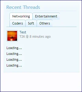

I have uninstalled my previous installation of XenPorta and newly installed 1.6.0 with my upgraded XF 1.2.3. Everything is working fine but none of RecentThread or RecentThreadx5 blocks are visible (not empty, it is totally invisible).
I have added those blocks in different positions, but not working anyhow. Other blocks are working (RecentAccordion block is showing blank as well, but I don't care as I have RecentFeatures which is working).
I have XFArcade and Resource Manager installed as extra addons.
Did anyone face this issue before?
