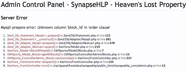

Hi, to start off, I hope I am posting this in the correct section.
So today, a few hours ago my XenForo website's portal spotted working. If you wish to see the errors, visit www.synapsehlp.com. The weird thing is is that this occurred randomly... nobody messed with anything. My best guess would be XenPorta is causing the problem, as every page but the portal seems to work. If this is indeed the problem, how would I go about fixing it. I am incredibly nooby so I may not understand completely a response. I do have access to the FTP and AdminPanel, so if you have suggestions I can make those changes there.
Thanks in advance D:
*ALSO, I am unsure about the RM build... where would I look to find this? (I put 1.1 down for now)

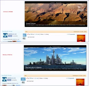

Furthermore, I want to report three issues with XenPorta and Google Chrome:
1) The date block goes under other blocks when I check "Push Date out of Block" (in RecentNews). This issue does not occur in Mozilla (see attachment 1).
2) The blocks can't be dragged in ACP->Xenporta->Layouts-Portal

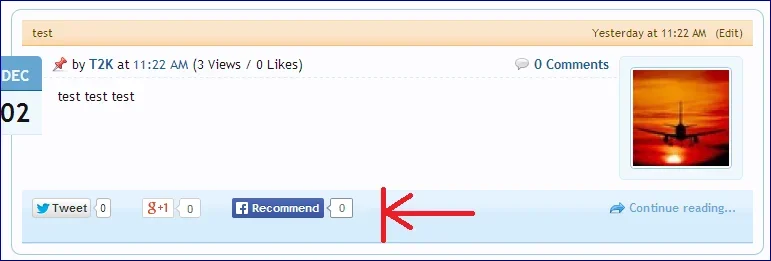

3) Footer alignment of RecentNews Blocks (attachment 2)
Thanks,
