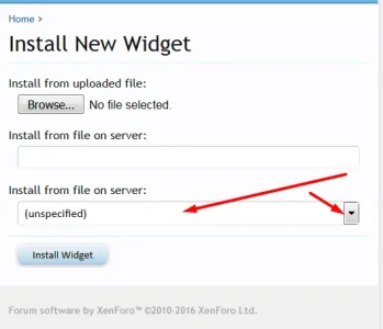

Go to the widgets plugin/add-on and "Install Widget". The widgets that come with the program are hidden in the dropdown menu. Click on the Google Adsense widget and install it. Then go to the widget and edit the options/settings if you so desire. Then go the the layout page and add the widget to your layout where you want it to show up.

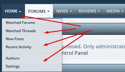

@Jaxel - or anyone else that might know. How can I remove the dropdown menu from the HOME tab (which is really the articles tab)? I don't want to remove them from the other tabs, just the HOME tab. XF says it is from an add-on and UI.X says it is from XenPorta, not them. All I want on that tab is a link to the home page... no dropdown. Thanks!
They are called Quick Links and I too hate them they are built into Xenforo you can use CSS to remove or try an addon
https://xenforo.com/community/resources/remove-quick-links.4949/
