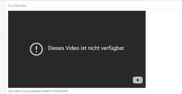

Got flooded with reports from my users/crew that all Youtube embeds are suddenly broken, seems also the case here
Quickfix: Edit template _media_site_embed_youtube and remove the &list={$list} from the iframe url

Had the same problem. YouTube embeds were working about 24 hours ago. Running 2.2.6 Patch 1.
Having '&list=' URL parameter causes the problem. Almost certainly a change in behavior on YouTube's side.

Same for me. I upgraded from 2.2.5 to 2.2.6 Patch 1 yesterday. Before updating, the embeded videos worked, since the patch it´s broken.
I tried the option with an additional link, the embedded part does not work, the link below works.
