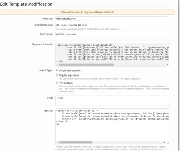

Hello,
I installed this add-on and I'm happy with it! But I would like to remove the link "Your Licenses" in the top dropdownmenu. I could'n find in the template where I can delete it. I set the option of "digital products" off, but the link is still in the dropdownmenu.
Is there any-one who can tell me to solve this?
Many thanks in advance!
It's not in a template, it's directly in a template modification.
You would have to edit the template modification called resources_tab_links for RM Marketplace.
Thank you for your answer, I changed

What ?! The code you edited is the template from XenForo Resource Manager ! Why did you touch that ? You should revert as you just removed all links.
I told you aboute Template modifications not Template.
Oops, sorry, I did not read your post well.
I found the template modification, but I can't edit it
Am I still looking in the wrong section?
No you are at the right location.
You just need to activate the debug mode temporarily:
https://xenforo.com/community/threads/frequently-asked-questions.5183/#post-248490
Then I would recommend you to disable that particular template modification and create a new one similar to this one but with only the links you need. Don't attach it to my add-on, that will then allow you to avoid any side issue upon upgrade as it would be overriden.
