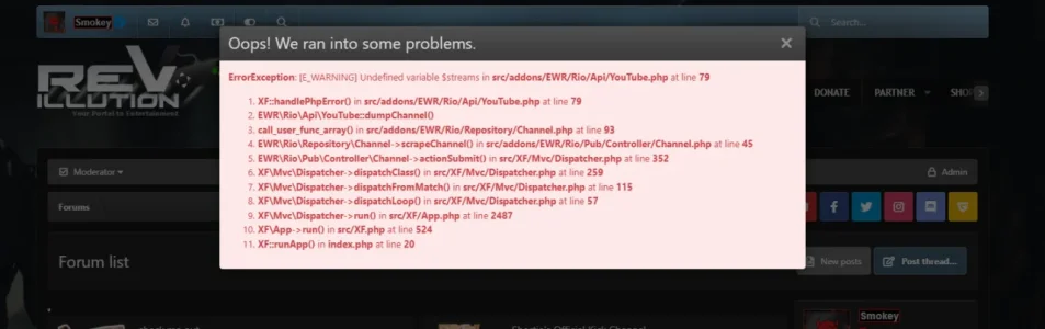

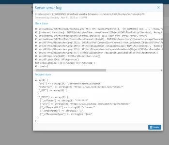

I upgraded.. uninstalled.. re-installed but i'm getting the same error any ideas.. cheers
ErrorException: [E_WARNING] Undefined variable $streams in src/addons/EWR/Rio/Api/YouTube.php at line 79
  1. XF::handlePhpError() in src/addons/EWR/Rio/Api/YouTube.php at line 79
  2. EWR\Rio\Api\YouTube::dumpChannel()
  3. call_user_func_array() in src/addons/EWR/Rio/Repository/Channel.php at line 93
  4. EWR\Rio\Repository\Channel->scrapeChannel() in src/addons/EWR/Rio/Admin/Controller/Channel.php at line 32
  5. EWR\Rio\Admin\Controller\Channel->actionScrape() in src/XF/Mvc/Dispatcher.php at line 352
  6. XF\Mvc\Dispatcher->dispatchClass() in src/XF/Mvc/Dispatcher.php at line 259
  7. XF\Mvc\Dispatcher->dispatchFromMatch() in src/XF/Mvc/Dispatcher.php at line 115
  8. XF\Mvc\Dispatcher->dispatchLoop() in src/XF/Mvc/Dispatcher.php at line 57
  9. XF\Mvc\Dispatcher->run() in src/XF/App.php at line 2487
  10. XF\App->run() in src/XF.php at line 524
  11. XF::runApp() in admin.php at line 13
That's just an error within the error catch itself. It's irrelevant, and can wait for another update to get fixed. The problem you are having is why the error is catching in the first place. You probably don't have an API key set up.

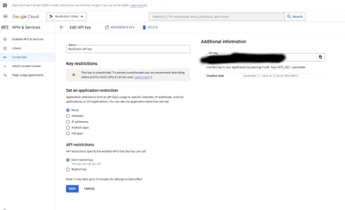

API Key setup and installed.. The Youtube API console is showing traffic but 100% errors - can't see what the error is though
For the Youtube API key, you only need 1 key? Or is 2 required? Also, i can't remember how I set that up....... any help would be appreciated.
@Jaxel , So i put the v3 app data key into the Youtube service and it still gives me an error when I try to add a youtube channel?

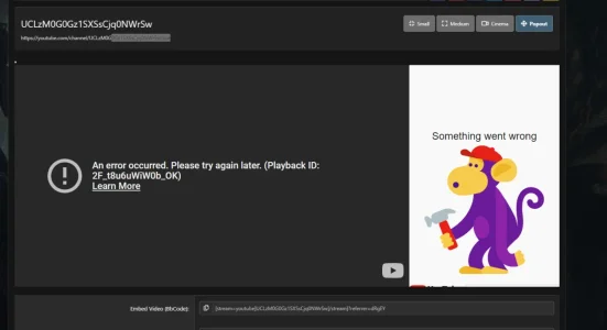

I tried adding a channel that was currently live using the actual URL to the stream itself and I got this error:
site: https://www.revillution.net
URL used to add:
Again, that error is irrelevant. It's an error within the error catch itself. The problem is you need to figure out what error is catching in the first place. I just tested your URL on my own site, and it worked fine. Which means your issue is with your API key most likely.

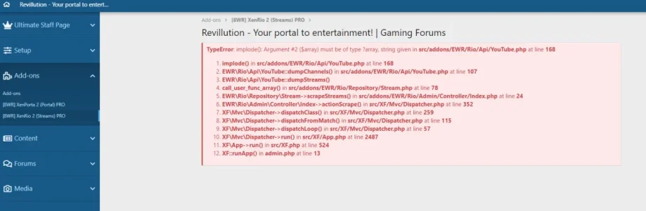

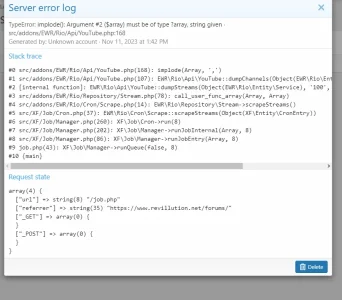

I think it's a "v1" API key, is that an issue? I can try making a new API key...... I made another and put it in and when i hit save i got this error:

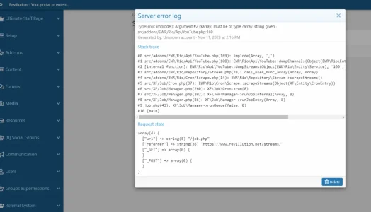

That happened when I force-scraped.....also left a server log.....I tried again and no dice. Same issue :(
Not sure what the problem is....I have my API key set up the way you said and it still doesn't want to work @Jaxel .
Also this:
I figured it out. There was a typo, that only got exposed if you did not have XenMedio as well.
Fixed now in 2.1.1.7a. You can download the file, upload and rebuild the addon.

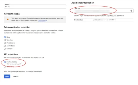

this is what my API is looking like:
