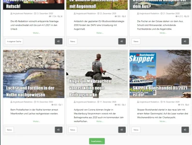

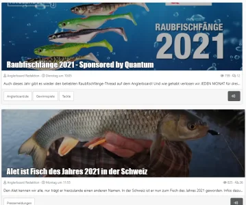

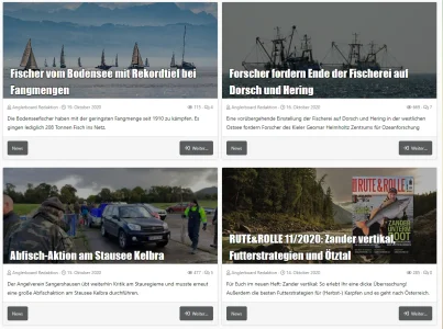

Where can I display the articles in 2 columns again?
This was my old depiction.
And this is the new one.
After upgrade I only have 2 columns before I had 3 which looked much better.. it was setup as you demonstrated but that seem not possible any longer?
@Jaxel Is there any way to have two columns again? I'm not happy with 3 on desktop. Thanks.

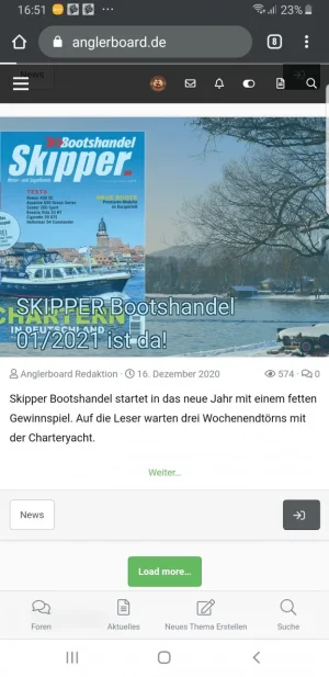

Thanks, Mendalla. It worked well on desktop, but not on tablet or mobile. This update is a disaster. My portal is totally ruined :cry:

Yes. Jaxel's updates are usually stable and improve things, but this one failed big time with the new flex box thingy. It doesn't fit well on mobile or tablet. 😭

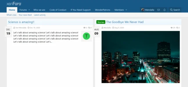

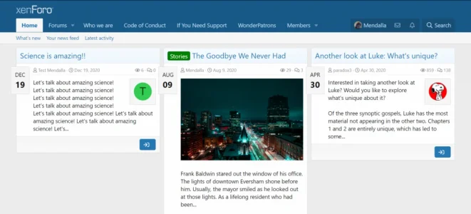

Okay, some screenshots to illustrate. These are done "out of box" with Default Style so that my styling is not a factor.
With the default "Masonry baseline width" setting of 350px, we get this on desktop:
Which does this on mobile (it's just a bit too wide, not terrible but a bit messy):
Now, that is fixable by changing to 300px but it still leaves us with three columns on desktop.
However, what I want (and I think @l3ta, too ) is something like this, which requires going to a higher px (this is 500):
However, that gives us this on mobile, which I cannot go to prod with:
So what we are asking is how to get a 2 column display on desktop and still have it adapt properly to a mobile screen. With the previous version, we could set "Masonry columns" to 2 to get the desired desktop display and that adapted properly down to one column on a small screen like my Galaxy.

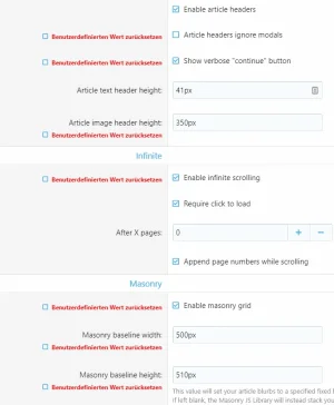

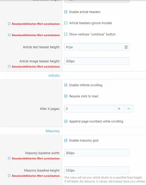

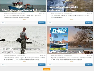

I played around a bit and tested. This are my preliminary results.
I have made the following settings.
2 columns
3 columns
It does not work 100%, but its near by.
Thanks for the input.
I still have to adjust margin and padding between Teaser and Continue (Weiter...). But it works.
