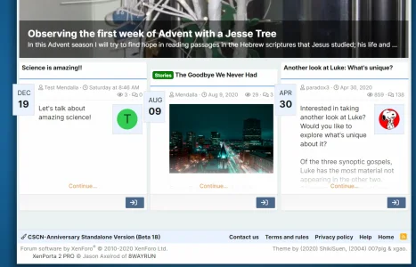

Here is what I am getting. This happens with the Masonry default shown below (or any px value in that box as far as I can tell). If I blank that box to use variable box heights, it is fine.
Gets this. Note the middle column. If I switch to another style, like default or my board's custom (based on Flat Awesome+ from Pixelexit), the tops line up.
Hope this helps you sort it out @ShikiSuen. I can use a different configuration in Xenporta to get around it, but it came to mind as a "glitch" that might be notable when I was posting about your style.

Looks like it requires a data-template-specific LESS template to rule how flex-boxes behave in any of such portal page.
If I'm gonna deal with this issue myself, then I'm afraid I have to buy a license from the dev.
Or, the dev install this theme to his demo forum (as a user-choosable non-default theme), and I view his demo forum to use Microsoft Edge (Chromium ver.) browser to inspect the CSS to see how the solution can go.
Or... Could you please do not uninstall this theme on your main site for a few days? Just leave this theme as non-default and I believe that not pretty much people will notice its existence.

@Jaxel May I suggest you to use flexbox or flexgrid in lieu of inline block, please?
Flexbox and flexgrid are comparatively modern comparing to inline block. Your plugin will have better compatibility with my CSCN anniversary style if using flexbox or flexgrid.

The CSS coding of this addon is too vintage, considering the HTML5 abilities that Chrome / Safari / FireFox shares in this year.
Flex is far better than blocks.
It's basically only changing 3 lines of code. I never changed them from blocks to flexboxes, because there was no advantage to them at the time. Why change from blocks, which had 100% browser compatibility, to flexboxes, which were new and had limited browser compatibility at the time. It's several years later now, and flexboxes are supported in every browser now. And as I said, its only changing 3 lines of code... so I've updated them to flexboxes for the next release.
