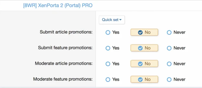

I want to allow members to promote their thread as an article but the submission must be approved by a moderator.
In user group permissions I set "Submit article promotions" to Yes and the promoted articles went straight to the Article List while the Moderator's approval queue is empty.
I looked into Note Permissions and found nothing related to Xenporta articles.
I'm running XenPorta 2 (Portal) PRO 2.0.2.5.
Did I miss something?

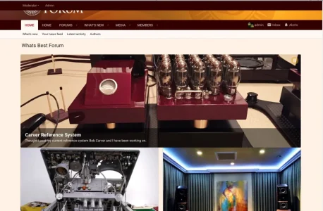

I am wanting to change the title style on the article header, so it is white out of a simple colour panel. i.e. I drop the white ghost blend and outlined title text. Also how can I increase the height of each porto photo for featured articles. It is a bit small in height for most images.
I can't find any CSS attached to the framework, or the php page to edit for this styling. No settings beyond the Admin setting to control this.
Help would be great guys.
Help please
With ref my earlier issue above, I have managed to add an image bar in colour behind the article titles, and it seems to work ok.
Now I have hit another issue. My slider is touching my articles underneath. I need a 20px margin/gap in there. I have no idea why it is butting up. I have 2px margin set in Xemfor between blocks in settings.
Also it seems the feature slider won't go wider than 1200px. I wanted my page set in Xenforo to 1240px wide, but the slide image only goes to 1200px even though it is 2000px wide as uploaded.
