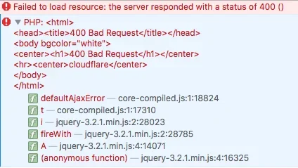

It looks like the issue is related to Cloudflare...
OK, will check it out. Any ideas though, it only is an issue with your add-on.

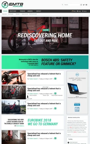

@Jaxel - am trying to add in a div at the top of the articles (the green box). Where would you recommend this added? We can get it at the top of the page but would like it as displayed in the attached image below, under featured but above first article.
Secondly, how could we add another one in between articles like the pic below (eg conditional)? PS, everything is complete apart from these 2 divs.
I realise this is likely outside scope of support but am attempting to make this fit real nice as a front page to the forum.
...am trying to add in a div at the top of the articles (the green box). Where would you recommend this added? We can get it at the top of the page but would like it as displayed in the attached image below, under featured but above first article.
- add HTML widget
- Advanced mode
- Template
<div class="block" {{ widget_data($widget) }}>
        <div class="block-container">
             <div class="block-body block-row">
                       Your stuff
              </div>
       </div>
</div>
-Display in positions: XenPorta > Articles list: Above (full)
-Display position: 2
