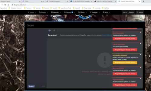

Hello
I have a problem displaying the chat on the forum the same as on your current site
Hello

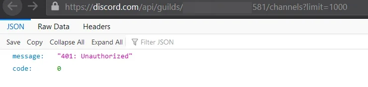

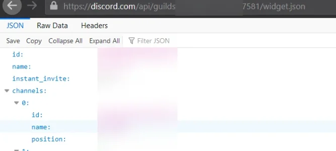

Getting this too, Widget is working on Discord, and enabled. Loading the json url itself is a 401 from xenforo.
But copying widget from discord,
Is it related to new options not shown in the video?

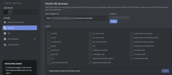

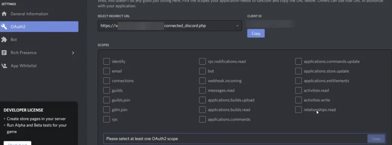

It now says "Please select at least one OAuth2 scope" so wondering is this is a new thing they've added? The old bot worked fine but we're started a new group so uninstalled the old one. Now it won't connect and spams the error log.
That url looks like,
https://discord.com/api/oauth2/authorize?client_id=removed&permissions=0&redirect_uri=https%3A%2F%2Fwww.removed.com%2Fconnected_discord.php&response_type=code&scope=identify%20email%20connections%20guilds%20guilds.join%20gdm.join%20rpc%20applications.commands%20applications.builds.read%20applications.builds.upload%20messages.read%20webhook.incoming%20bot%20rpc.notifications.read%20applications.commands.update%20applications.store.update%20applications.entitlements%20activities.read%20activities.write%20relationships.read

This addon doesn't need any scopes from Discord.

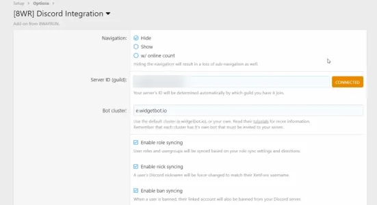

I've done everything as your video says. It still errors. The options screen has changed on Discord compared to your video but I've done everything as before.
It even says connected here. But the error logs are spammed with 403's
It says "missing access" but all auth options are enabled,
  • XF\PrintableException: An error occurred while connecting with Discord. Please try again later.: Client error: GET https://discord.com/api/guilds/removed/members/removed?limit=1000 resulted in a 403 Forbidden response: {"message": "Missing Access", "code": 50001}
  • src/addons/EWR/Discord/Repository/Discord.php:60
But the Widget etc is public. I can browse it and view all user / server info via the api.
General Information on Discord now lists a public key, is this needed? As there's nowhere to put and I've tried this and the bots key.
OAuth2 has both connected_discord.php and connected_account.php set. (in image I've tried both) It says "please select at least one OAuth2 scope" then gives the url.
OAuth2 alone works, it's just the connection which says connected but results in a 403 so wondering if they've made backend changes?
EDIT: Just tried a totally different account with a seperate discord server, the exact issue happens again. I think Discord has changed something their side which is breaking. OAuth2 works, Bot can be added/connection works but it 403's and spams the error logs.
