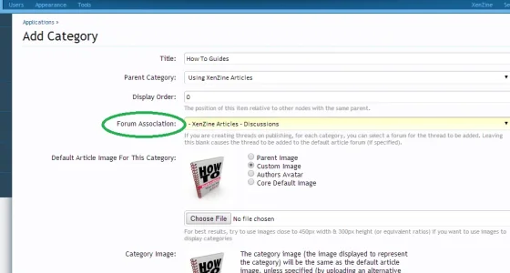

@Thom Tyler Are you using a "Default Article Forum" or have you specified a "Forum Association" for your Article Category?
Try editing a category and adding the forum association:

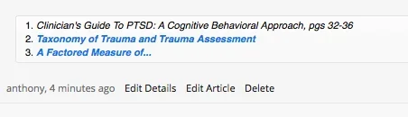

Resource box is cutting characters at a defined amount instead of respecting the options setting.
I have the options set to 2000 words and it's cutting the below off at item 4, word complex:
1. Taylor, The Guilford Press, 2006, [I]Clinician's Guide To PTSD: A Cognitive Behavioral Approach, pgs 32-36[/I]
2. Kira, 2001, [I][URL='https://www.myptsd.com/c/gallery/-pdf/1-88.pdf']Taxonomy of Trauma and Trauma Assessment[/URL][/I]
3. Jones, 1969, [I][URL='https://www.myptsd.com/c/gallery/-pdf/1-89.pdf']A Factored Measure of Ellis' Irrational Belief System, with Personality and Maladjustment Correlates[/URL][/I]
4. Herman, 1992, [URL='https://www.myptsd.com/c/gallery/-pdf/1-90.pdf']Complex PTSD: A Syndrome in Survivors of Prolonged and Repeated Trauma[/URL]
It still cut it off after cutting it right back....
I see, it's the resource box input textarea that is limiting (to 500 chars), just fixed:
