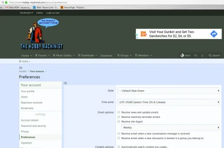

Step 1: Set my style to something distinctive. Please take note of two keypoints: a) I'm currently logged in as vtcnc and b) my style name: Default Style Green.
204533
___

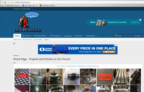

Step 2: Login as User from profile vtcnc. Please take special notice of two keypoints on the screen shot below. a) once logged in as user Gunner, the Revert User should say "vtcnc". Instead, it says metalman66. b) Also take note of user "Gunner" style. It is default, not to be confused with Xenforo Default.
204534
___
Step 3: Revert User. Take note of two keypoints: a) even though previous screen said I was metalman66, it reverted me back to vtcnc. b) Note how my style did not revert back to Default Style Green. This in fact is the style of metalman66.
204535
__

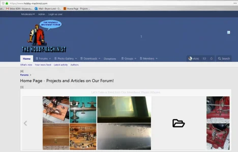

Step 4: from previous screen profile vtcnc, login as user wa5cab. wa5cab is the moderator who first reported this problem. Take note of two keypoints: a) revert user should say vtcnc, it says debrular. Note that the style is that set by user wa5cab.
204536
___
Step 5: Revert user to vtcnc. Take note of two keypoints - a) I am back to my profile as expected, b) the style is vbulletin 4, which happens to be the style of user debrular (see previous screen shot in Step 4, above.
204537

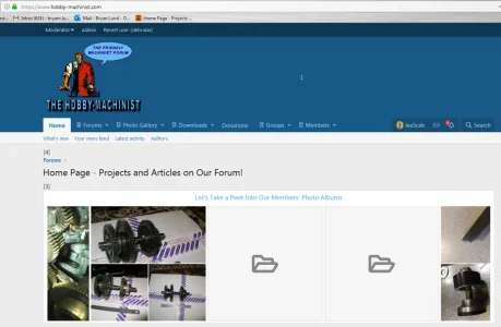

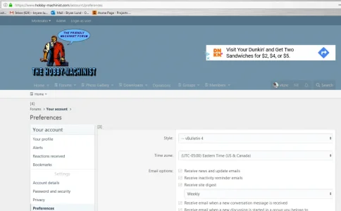

Step 5 - Verification that my style has been changed after using the Login as User add-in.
204538
Hopefully these screen shots help you diagnose and troubleshoot the problem.
