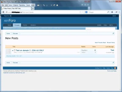

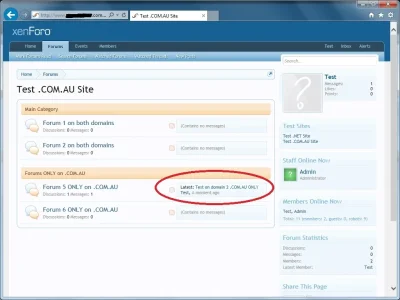

I create a thread in a forum that is displayed ONLY on domain 2:
Yet, that new post comes up on domain 1's "New Posts" even though your addon settings are marked not to:

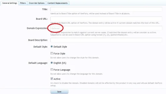

Can anyone advise what this means:
"3. Regular expressions in for domain matching. Allows to match dynamic URLs and to serve the same domain for them, using placeholders in Board URL option field."
and what do you put in this field in the domain settings?

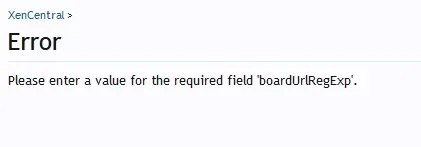

The field in the settings says it is "Optional"
BUT if you don't put anything in it, you get an error:

For the error provided, it seems the product was not correctly applied. For each upgraded version you should re-upload all files and re-import product XML (not only upload, and not the other way). The version just introduces a new field in database table, which should be added during re-importing. Please do this and let us know if you are still getting the error.
As for the field, yes, it is optional, and just leave it empty if you are not sure how to use it. The main purpose of it is to support wildcard domains, and have only one domain entry created for them. It is perfect for the cases when you provide users theirs own XenForo installations with subdomains like user1.domain.com, users2.domain.com etc. and want to apply the same rules to all these domains (same set of forums etc.), of course having different board URLs. For that you will use something like this:
Board URL: http://{1}.domain.com
RegExp: #(\w+)\.domain.\com#
Anyway, this is a specific case needed for some customers only and you can just ignore it.
