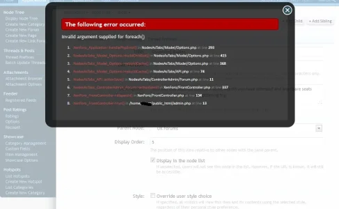

Found a bug...
I am using Nodes As Tabs addon and when I tried to move a forum node into a different category node it eventually did it ok however I was presented with the following error:
Error Info
ErrorException: Invalid argument supplied for foreach() - library/NodesAsTabs/Model/Options.php:307
Generated By: Admin, 6 minutes ago

This was done on a test site which is a copy of my live site. However doing the same thing on my live site (without this addon installed) did not produce any error so it is specific to this addon

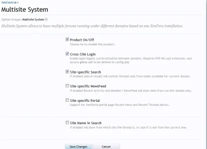

Found another bug...I have selected the search to only search the specific domain:
However searching for a thread title on one domain that I know is only on the other domain still brings it up in the search results...NOTE, I am using the XF Enhanced Search Addon (Elasticsearch)
Is there any way to have the "New Posts" to only display the new ones on the specific site...this is one function my users use all the time and it would be pointless if they were also seeing new posts made on the other domain
Found a bug...
Error Info
This is not a bug in our product. Our product just does not allow to access a forum under different domain, like it just does not exist. The product you are using queries for the node and assumes it is found, but actually it does not exist and its children can not be used in "foreach". However, checking product code we see the product has a line to prevent this error, so maybe you are using an older version. Please contact product vendor if you still have the problem after upgrading to the latest version.
This should work and works fine with default search engine. We will check it with Elasticsearch and update you about the results.
This is related to the previous issue. New Posts is actually using search engine, and once the product is fixed to work with Enhanced Search it will show correct New Posts.
We will update you soon about the fixes.

Thanks for your reply and yes, I was using Nodes As Tabs v1.2.0. When trying to update Nodes As Tabs to v 1.2.1 I received this error:
Server Error
    XenForo_Application::handlePhpError() in NodesAsTabs/Model/Options.php at line 293

The only way to update Nodes As Tabs was to turn your addon off, then update, then turn your addon back on. However, I still get the same error when trying to move a node in the ACP"
Changing a forum node:
After clicking Save"
The only way I can do anything in the ACP Node Tree is to turn your addon off first so I don't get the error.
You are welcome to the test site Admin login details if you want but the issue seems that your addon doesn't work well with Nodes As Tabs

The problem just still exists on that line of the product. A simple IF condition will fix it. Attaching the file with change needed that you can just apply to your board. By the way, our product does not make any changes in Admin CP.

Where do I place the Options.php file...I placed it in the Model folder of your addon and the issue still exists so I take it that isn't the place
Hello,
It is not a fix for our addon, it is for the addon you are using. It should be placed in NodesAsTabs/Model directory. Please restore the Options.php of our product using the package you have downloaded.

That fixed it...thanks
