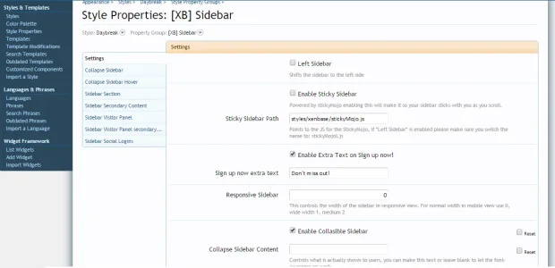

Heyo, hope I'm in the right place here. Is there a way to make the collapsible sidebar option so that it collapses in forum view, but permanent in forum list?
Some of my members dislike the sidebar in forum view but still want to be able to view it in the forum list/main page without having to click the collapse button every time.
There isn't a collapsible sidebar in XenBase. You must have an add-on installed doing that, ToggleMe is one.
Forgive me, as there is more than one administrator for my board and we all tend to install things, but is [XB] Sidebar not a property for XenBase?
Sidebar Properties
  • Collapsible Sidebar
I am now but a confused noodle.
ohhh - that's what I get for replying on my phone. I totally misunderstood that for collapsible sidebar blocks. We can look into it but just note we develop from the default setup, no add-ons. Assuming you must have Widget Framework installed?
