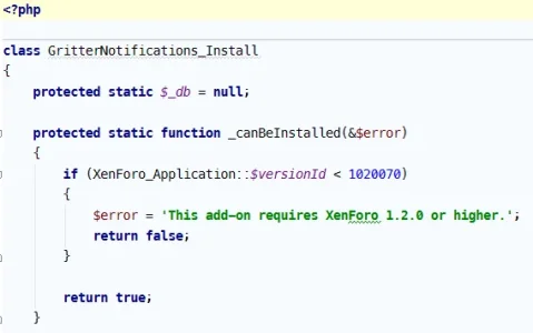

Install version 1.7.1. That removes the 1.3 requirement.
Sorry man - my bad. I uploaded the files to the wrong spotI just re-downloaded to double check the code:
1020070 is the version ID for XenForo 1.2 stable.
Make sure you have downloaded 1.7.1 and have also uploaded all files from it, replacing all existing files. Make sure your FTP client reports that the files, specifically Install.php have uploaded successfully.
