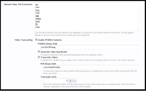

Generally, if you go to Gallery Options > Video Options and the options to transcode are all enabled (FFmpeg binary path and PHP binary path need to be filled in and correct, too) and you click save, you will get errors if anything isn't set up correctly.
If you don't get any errors and it still doesn't work, try and send me one of the videos, if possible.
i didn't get any errors after saving, i also tried an .mp4 and it uploaded fine,
I've had problems with .mpg, .avi, & 1 .flv file but another flv video worked fine
These are my settings,

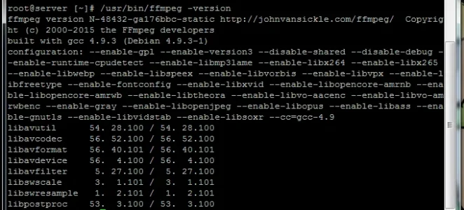

Here is my ffmpeg info

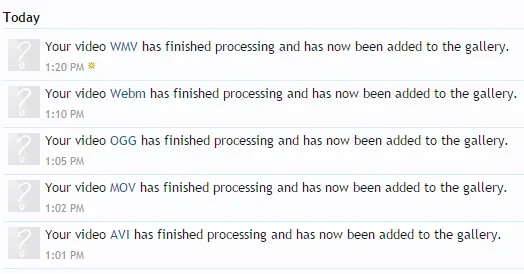

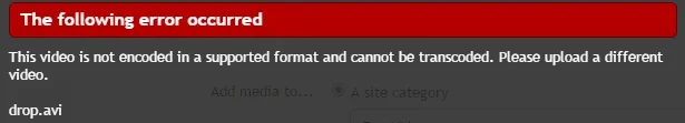

In the media gallery on xenforo here it says under allowed extensions:
I tried to upload:
.avi
.mov
.ogg
.webm
.wmv
and i got this message

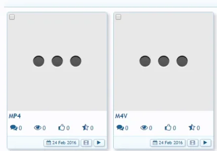

I was only able to successfully upload mp4 & m4v here on xenforo.com
And as you can see the thumbnails did not work.
So i believe it's not only my server,
Here are the 7 video files i used,
http://www.filedropper.com/samplevideos
FFmpeg was somewhat recently disabled here, so that's not particularly surprising -- without it, only one format is supported. I'll need to re-enable it.

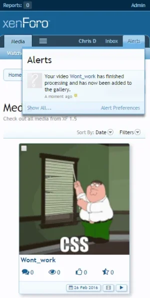

Here is one of the videos i tried to upload, .wmv file(2.49MB)
http://www.filedropper.com/wontwork
Works:
This also works but it didn't generate a thumbnail -- that's not a massive concern, though.

All 7 worked fine (2 didn't require transcoding).
I would try a different FFmpeg version, and look at what changes you have made since it last worked. Something will have changed on the server to trigger this to stop working.

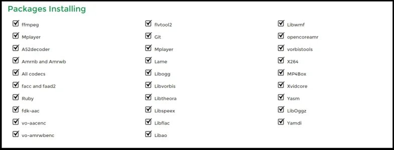

I ended up searching online and finding an Free FFMPEG autoinstaller.
Here's the website:
http://ffmpeginstaller.com/
I used putty and following these instructions:
http://thoaimedia.com/how-to-install-ffmpeg-auto-installer-on-centos/
mkdir ~/ffmpeg-packages
cd ~/ffmpeg-packages
wget http://LINKTO NEWEST VERSION HERE
tar -xvzf ffmpeginstaller.8.0.tar.gz
cd ffmpeginstaller.8.0
./install.sh
it was so easy!
This autoinstaller not only installed ffmpeg, but installed a bunch of other things, not sure if i needed them...
but oh well.. there's no option to only install ffmpeg
anyways.. ffmpeg now works!
