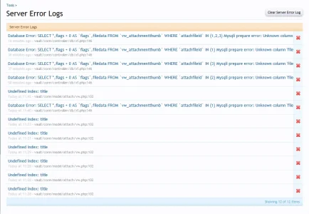

When deleting an attachment page it throws the following error:
Server Error
Database Error: SELECT *,flags + 0 AS `flags`,filedata FROM `vw_attachmentthumb` WHERE `attachfileid` IN (2) Mysqli prepare error: Unknown column 'filedata' in 'field list'
    vw_DB_Controller_XF->throw_error() in /home/airportc/public_html/vault/core/controller/db/xf.php at line 160
    vw_DB_Controller_XF->query_read() in /home/airportc/public_html/vault/core/model/db/mysql/vw.php at line 29
    vw_DB_MySQL_Model->select() in /home/airportc/public_html/vault/core/controller/dm/attach/file/vw.php at line 458
    vw_DM_Attach_File_Controller->delete_multiple() in /home/airportc/public_html/vault/core/controller/dm/vw.php at line 113
    vw_DM_Controller->delete_multiple() in /home/airportc/public_html/vault/core/controller/dm/attach/edit/vw.php at line 619
    vw_DM_Attach_Edit_Controller->delete_multiple() in /home/airportc/public_html/vault/core/controller/dm/vw.php at line 113
    vw_DM_Controller->delete_multiple() in /home/airportc/public_html/vault/core/controller/dm/attach/vw.php at line 458
    vw_DM_Attach_Controller->delete_multiple() in /home/airportc/public_html/vault/core/controller/dm/vw.php at line 113
    vw_DM_Controller->delete_multiple() in /home/airportc/public_html/vault/core/controller/dm/page/vw.php at line 1860
    vw_DM_Page_Controller->delete_multiple() in /home/airportc/public_html/vault/core/controller/dm/vw.php at line 113
    vw_DM_Controller->delete_multiple() in /home/airportc/public_html/vault/core/controller/ui/imod/vw.php at line 385
    vw_UI_iMod_Controller->kill() in /home/airportc/public_html/vault/core/controller/ui/imod/vw.php at line 108
    vw_UI_iMod_Controller->execute() in vw/XenForo/ControllerPublic/Wiki/Moderate.php at line 50
    vw_XenForo_ControllerPublic_Wiki_Moderate->actionIndex() in XenForo/FrontController.php at line 347
    XenForo_FrontController->dispatch() in XenForo/FrontController.php at line 134
    XenForo_FrontController->run() in /home/airportc/public_html/index.php at line 13
