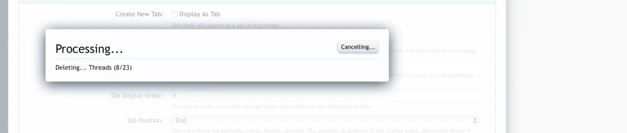

I'm allowing this process to continue though it's unusual and then I see something along the lines of [Rebuild: Deleting threads ... (17 of 213)].
I attempted to cancel the rebuild/thread delete. At this point I realize I'm missing an entire forum category.

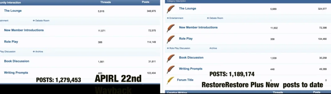

Still, the numbers don't quite work, going strictly by the forum statistic totals. Before this issue there were approximately 69,000 threads and 1,280,000 posts (April 16th). Presently, there are approximately 49,000 threads and 607,000 posts (April 27). The query showed 81311 orphaned threads. I'm assuming that number includes orphaned threads created by the deleted nodes, but also by past deleted threads or other pre-existing orphaned threads? Duplicate content? Is there a way to query the number of posts associated with the orphaned threads, or some other way to determine if all the missing content is still in the database?

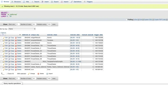

In terms of the manual rebuild processes message, to be safe, I would empty the xf_deferred table. You don't want to accidentally condition the thread deletion processes (that would be triggered by the node deletions).

It shows 448 threads and 49385 posts. It should be closer to 485 threads and 103,404 posts according to the most recent cache on TheWayBack Machine. If content was deleted, it'd delete it by the thread, not posts, correct? In which case the counter is off or there are still orphaned threads that should be in node #6. I'm not sure how to interpret this information.

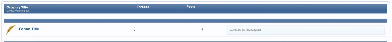

INSERT  INTO  `xf_node`(  `node_id`,  `title`,  `description`,  `node_type_id`,  `parent_node_id`,  `display_order`,  `display_in_list`,  `lft`,  `rgt`,  `depth`,  `style_id`,  `effective_style_id`,  `breadcrumb_data`  )
VALUES(
'1',  'Category Title',  'Category Description',  'Category',  '0',  '1',  '1',  '0',  '0',  '0',  '0',  '0',  'a:0:{}'
Note: While the category that housed all the missing forums was node #1, I don't believe node #2 was in use.
This is probably ok. It might be that the nested set info needs to be updated now.

I originally deleted xf_deferred as recommend but had to reinstall the test installation and forgot to re-empty xf_deferred. This is a test installation, fortunately. In my opinion any thread deletions that were triggered just now wouldn't have been enough to delete all the nodes so we should still get some results, especially since they were still listed in xf_deferred. If you think this spoiled the process I can restore the database and try again from this point after ensuring xf_deferred is re-emptied.

It looks like for the most part, content is preserved. However, I'm about 100,000 posts of the 800,000 or so that went missing.
What are your thoughts? Was that missing content deleted by the deferred process triggered originally by the add-on? Is it still in the database somewhere as an orphaned thread? Are there any other rebuild processes that might bring the missing threads to light? If it's gone for good, should I accept this as a victory or attempt a merger?
I would probably be close to calling this one a victory.
Whatever you do next, make sure you take a full back up just in case anything goes wrong that didn't happen during this testing.
But, yeah, I suspect you might not get much better than this. The whole idea of the process is it aims to not leave orphaned threads so the ones which are missing are likely gone for good.
