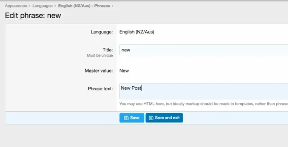

Trying to update the following phrase:
New (happens with others too)
191259

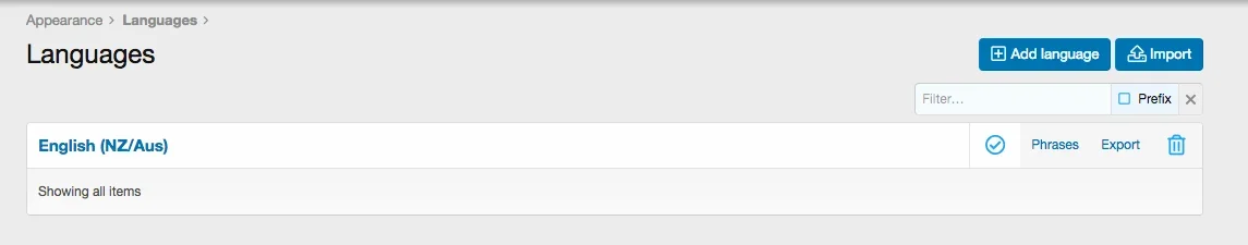

Also noticed i dont have a 'master' language...thought id seen it before. dont have it either on my XF1.5 board nor my test site (XF2.1 Beta 5). Not sure if its related.

This won't be add-on related -- unless an add-on has deleted the table, which would be pretty insane.
As mentioned in the linked thread, this can be indicative of DB corruption. You may be able to recreate the table (as this doesn't really contain data that isn't rebuildable), though I'm willing to bet that will fail if you just run a create table query. You'll probably need to drop the table first, even though it may not even appear in the table list.
Corruption like this generally relates to an issue with MySQL itself, MySQL being stopped without following the normal shutdown, or even a potential hardware issue. Software can't (or shouldn't be able to) trigger corruption like this.

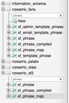

SQL to recreate the table Mike?
It might be worth to post the result of the following query
SQL:
SHOW TABLES LIKE 'xf\_%'
localhost/nzwarrio_xf2/xf_phrase_map/
Your SQL query has been executed successfully.
This should work:
CREATE TABLE `xf_template_phrase` (
  `template_id` int(10) UNSIGNED NOT NULL,
  `phrase_title` varbinary(100) NOT NULL,
  PRIMARY KEY (`template_id`,`phrase_title`),
  KEY `phrase_title` (`phrase_title`)
) ENGINE=InnoDB CHARACTER SET utf8mb4 COLLATE utf8mb4_general_ci;

I was able to fix it by doing the following:
  1. Close the forum
  2. Export the database sans the xf_template_phrase table with this:
Bash:
mysqldump -v --single-transaction --quick --default-character-set=utf8mb4 --ignore-table=database_name.xf_template_phrase  database_name > /home/somefolder/export_name.sql
  1. Create a new database
  2. Import the above export into the database
  3. Run the following MySQL command to add the table to the new database:
SQL:
CREATE TABLE `xf_template_phrase` (`template_id` int(10) UNSIGNED NOT NULL, `phrase_title` varbinary(100) NOT NULL, PRIMARY KEY (`template_id`,`phrase_title`), KEY `phrase_title` (`phrase_title`)) ENGINE=InnoDB CHARACTER SET utf8mb4 COLLATE utf8mb4_general_ci
6. Drop old database and rename new database to the name the old one was using (alternatively, you could just update config to use the new db name - I did that initially to make sure it worked before killing the old one).
