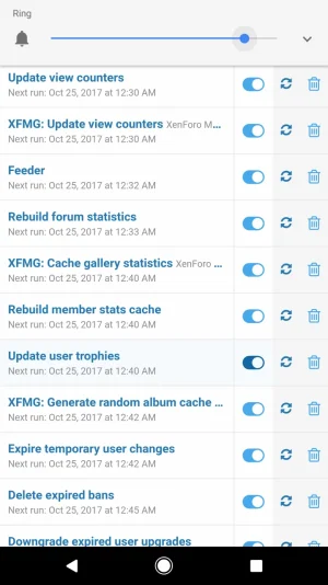

I've noticed that since 10/25 none of my business statistics are updating. We're getting more traffic and activity but everything shows zero. I try to run the update daily stats and get this error.

The one recent plugin around that time I added is the Reactions?
