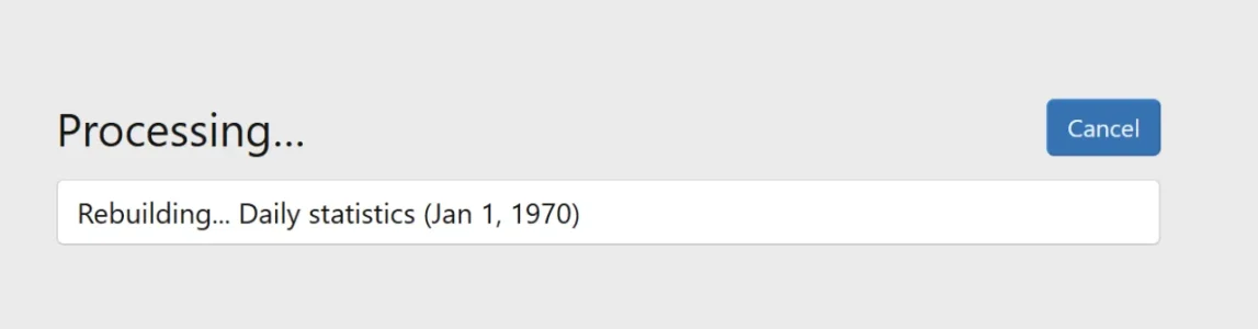

Just tried and process stuck here:
This will be a separate issue, but I have not been able to reproduce it yet.

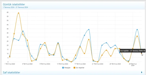

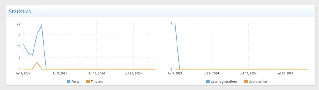

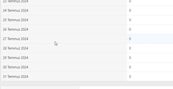

But my stats are gone !!

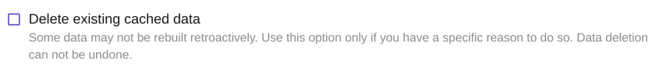

Did you check the option to delete the existing data before rebuilding?

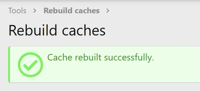

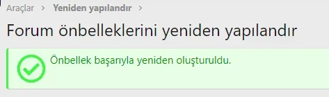

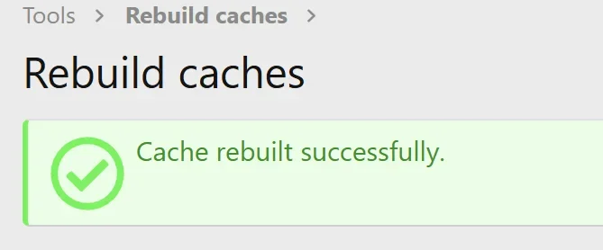

I tried it just now and there was no problem. I marked delete cache
Evet, etkin kullanıcı istatistikleri sıfırlandı
Per the explainer, active user counts cannot be rebuilt retroactively:

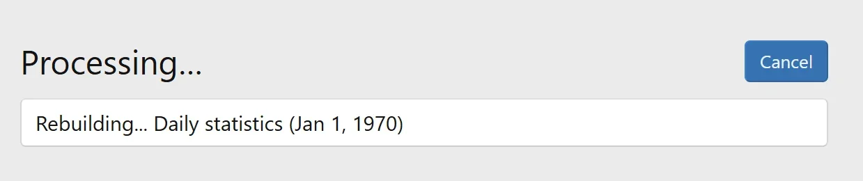

It shouldn't take that long. Is it progressing at all or is it hung at a certain date? I can rebuild ~14 years of stats in a couple minutes. Do you have any add-ons which add additional stats?
It seems to be rebuilding through the months and at 30k-ish posts. It seems to be progressing from what I can see but taking so long! Is there a setting I need to set to speed it up?
Not really, other than maybe trying a smaller batch size to see if it helps. It could point to broader MySQL server/configuration issues but it's hard to make any particular recommendations.
