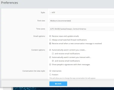

When i'm in the user preferences pane and attempt to adjust my email preferences to always receive email notifiations, I get the below error:

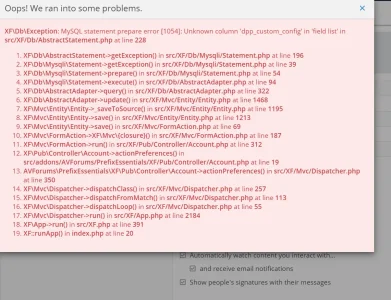

XF\Db\Exception: MySQL statement prepare error [1054]: Unknown column 'dpp_custom_config' in 'field list' in src/XF/Db/AbstractStatement.php at line 228

It’s caused by an add-on that you may have had enabled in 1.5 that changed the database to add a field that doesn’t have a default value and now there isn’t any code setting that value it now errors.
You will either need to enable that add-on, seek support of the developer on how to fix that issue or simply remove that field from the database.
Unfortunately it isn’t clear which table this field is in but it is likely to be one of the xf_user tables.

Strangely I actually misread the error as something else. But, still, the column isn’t a default column so it has been added by an add-on. In this case it’s saying it’s an unknown column, so it means there is code that expects the column to exist but it doesn’t.
You would have to try and figure out which add-on it comes from and seek support from its developer.
I suspect that disabling the problematic add-on should make the error go away so that should help identify which it is.
