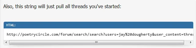

I'm using pretty much a stock theme, so it's not the theme. The issue is that no horizontal scroll bar is created in the code box, so it's impossible, with long code, to move to the right in order to see/select it all. The left-right scroll bar is created in redactor.

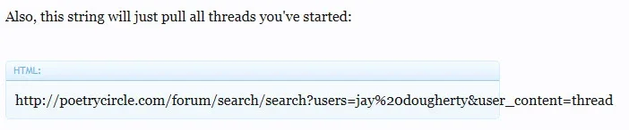

Update: Something interesting. I switched to an alternate theme on my site. It's the "soft responsive" theme available here. With that theme, the horizontal scroll bar does appear, and all is well with code. Very odd. I'm not sure why the scroll bar is not appearing with my more stock version of xenforo.
Here's an example of an HTML box in the stock theme that I'm using.
Here's an example of an HTML box in the soft responsive alternate theme that I have.

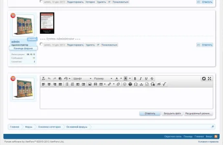

Just getting used to this editor which is great, but doesnt really go too well with my theme as the toolbar sits at quite a deep shade of grey currently.
Please could you advise which style property i need to edit to customise this?

Yeah, post a screen shot or link.
@Dubbed Navigator try to not use in TinyMCE XenForo style properties integration and use "lightgray" style of TinyMCE.
Go to Apperance -> Style properties -> TinyMCE Quattro (admin.php?styles/1/style-properties&group=sedo_tinyquattro) and uncheck upper checkbox.
Great stuff, thats sorted it. Thank you :)

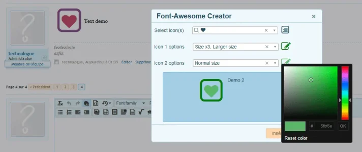

Speaking of user interface, here's one that looks finished :
It has been a nightmare to code, but it looks good.

Now to come back to the subject, create user interface inside editors can take time. For the TinyMCE Quattro addon, you can use the standard TinyMCE 4.x method. It's fast to load, 100% done programmatically, but it's not that easy to program and you don't have all the advantage of the second one. This second one is loading a XenForo template inside a TinyMCE modal, which means you can use all the XenForo templates tags, you can easily load Javascript, css, etc. And you can also have access to the editor text selection before the overlay was called. The drawback is that it takes a little more time to load, but it lets developers create advanced ui (check this addon for example). I've chosen to use that second method to port XenForo official editor ui to TinyMCE 4, so that they can be used as a demo to create other ui (with the help of the FAQ if needed).
