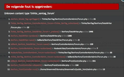

Hello,
I have a little error and i can't solve it myself.
When i create a new (sub)forum or when i edit a existing one i get the error message as the attachment. Schermafbeelding 2015-10-15 om 19.20.02.webp The problem is in, as far as i can see, the Tinhte Xentag addon. When i disable the addon i can create and edit the forum without any errors.
I use 1.5.1 Xenforo and 3.1.3 Xentag.
Is there anybody who could help me with this issue?

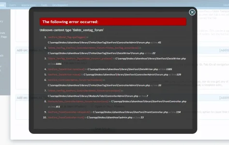

Hello,
When i create a new (sub)forum or when i edit a existing one i get the error message as the attachment. View attachment 119472 The problem is in, as far as i can see, the Tinhte Xentag addon. When i disable the addon i can create and edit the forum without any errors.
Look like the installer hasn't run properly. Please try to upgrade the add-on with the XML again.
Oh wow.......is it that simple :oops: I did not even try that. I did all the things said in the update info but not reinstalled it. That was the problem.
Txs, it works just fine again (y)

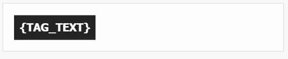

But the Tag Cloud when i'm using Widget Framework became like this in my sidebar:
FYI that i did follow this step as well:
  • Xenforo Migration tool (AdminCP > Tools > Rebuild Caches >Upgrade Tags for XenForo 1.5+).
Anyone encountered the same issue?
Could you advise how can i fix this?
Thanks! :(

Hi Guys,
After i upgraded my board to Xenforo version 1.5.2 when found out the issue as:
Then i also did follow the instruction to run this:
Thanks! :(

Hi Guys,
Thanks! :(
Please check for outdated templates in your style?
