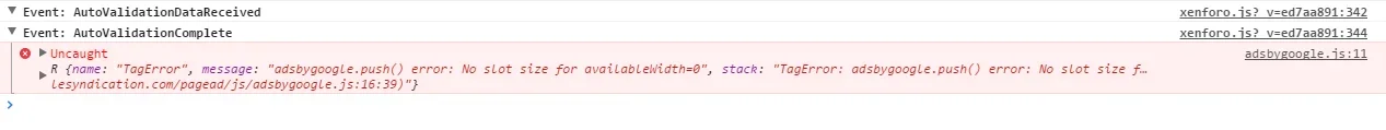

This is really odd I and my users are getting it. Have tried disabling all addons as well.
I am running php7 with redis cache these would be causing issues would they?
Dont have this issue in any threads just within tickets.

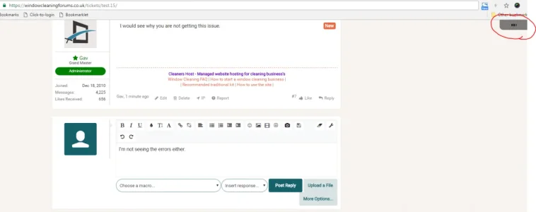

I've just tried as well on your site Gavin, and I'm not getting errors either.
Actually, new ticket posts fine. Replying to a ticket.......
Spinny mc spin face.

Honestly, I think it's a browser extension since I'm not able to reproduce it (nor can @MattW) and I've seen a similar thing happen in threads when an ad blocker is enabled.

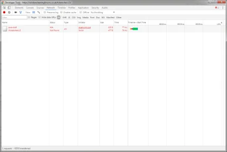

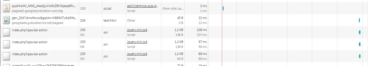

I think it's related to the ads running on the page, as the page waterfall hangs on the Google ad being loaded at the bottom of the page, and then it returns a 204 status
It's the ads causing the issue
It can't calculate the value / position correctly during the quick reply.
It can't be a browser extension as iOS safari has non. I have set with conditionals to show add after every first post on the forum and after last post. Would this be the issue the ads are placed in the default xenforo ad positions with conditionals for the places they display.
I'm using Chrome on Windows 7, so it's not a browser issue. It's specifically down to the ads. I suspect it's your ads manager addon, not being able to calculate the width correctly. I helped fault find something similar with the ThemeHouse ad manager addon causing the exact same errors.
Yes but the ads add-on only serves non Adsense ads. The Adsense adds are within templates.
I just tested by deleting the ad code from ad_above_top_breadcrumb, and it now allows you to post a reply to the ticket. What I have just seen, is that you are also serving an add below the message, so something is conflicting with the ads you have
Ok so if it's the ads. What would I target with a conditional to not show those ads in tickets. Dont need them to show in tickets anyway.
Did you put the code back Matt as want them to show for the rest of the forum just maybe there is a conditional I can use to not show it in tickets.
WCF_AFTER_FIRST_POST is the ad I can see being served (or not being served correctly).

Ok on the right track so if I use nf_tickets_view that seems to work BUT only on first reply once that reply loads the ad after thread shows and subsequent replys have the error, if you refresh the page the ad goes away and you can make one more reply before the ad causes issues again hope that makes sense.

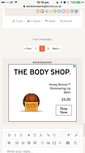

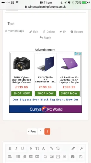

Just as a side note it seems that tickets is showing the ad in a slightly different place opposed to threads. I can't seem to stop that particular ad showing in tickets.

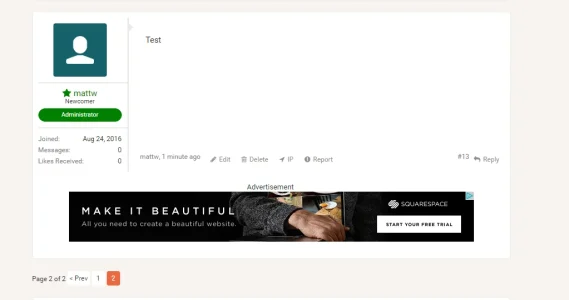

In threads it displays like this.
In tickets it displays like this.
